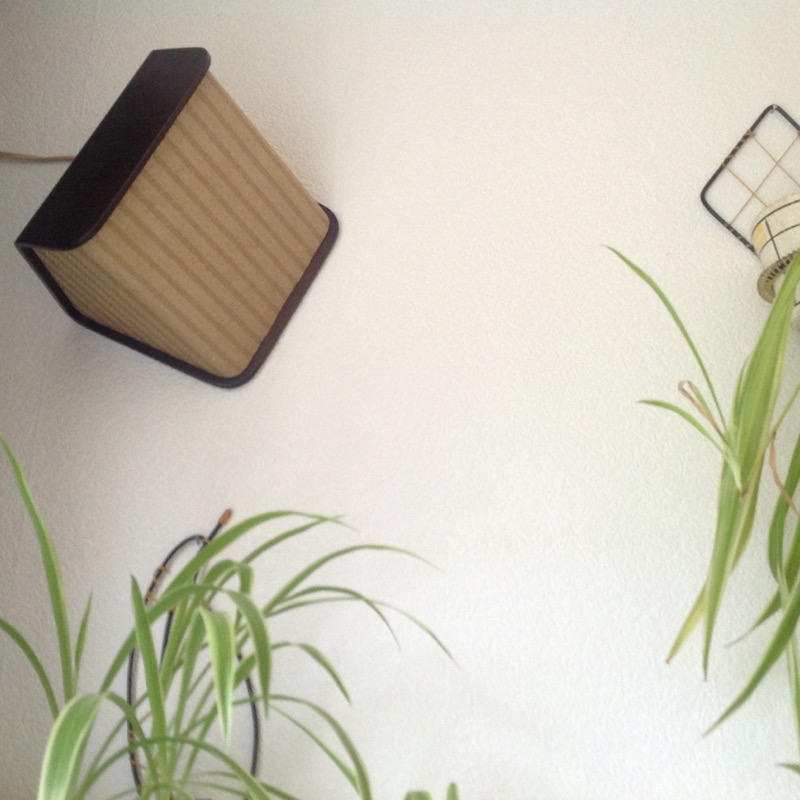

In 2013 a here wel known model was on the front page of the magazine of
the Dutch Association of the History of the Radio.
The owner is regularly on this forum ands will tell you about his model.
Are the two external speakers also in your possession?
If not, they can be found. The will give a beter wide range (stereo or mono) sound.
AD5036B. A very cleaver designed speaker to hang in different positions easily.

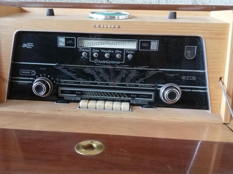

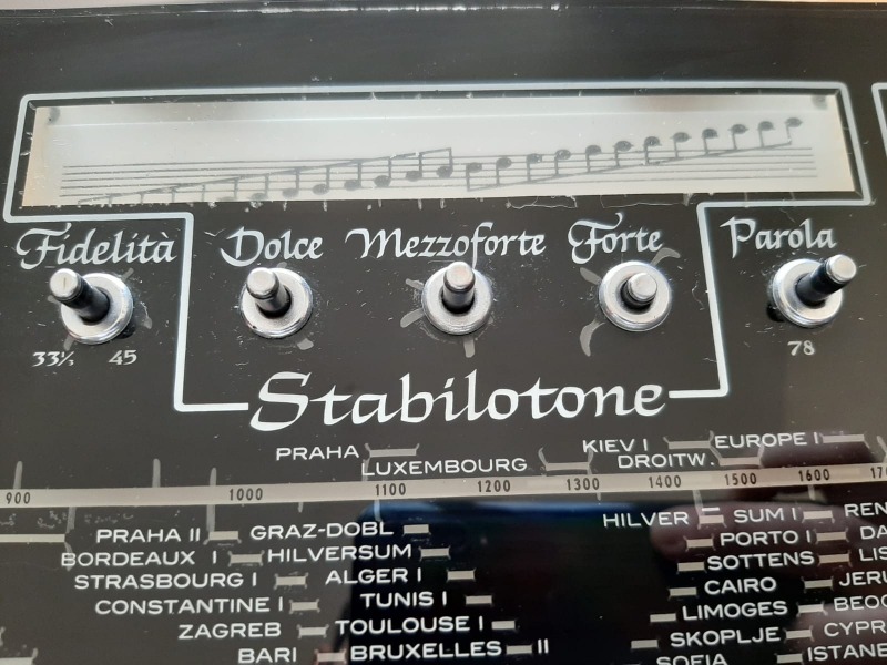

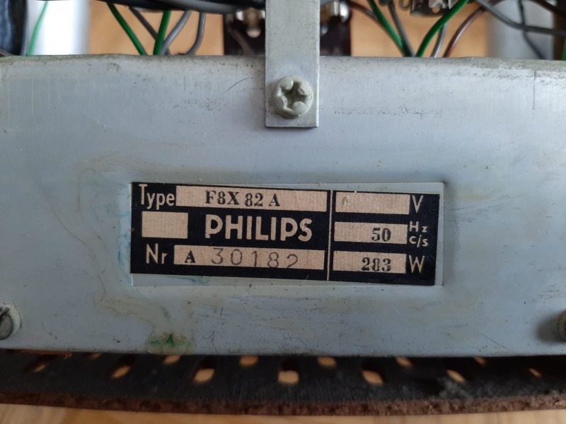

I come to talk with you because the main informations that I was able to find on this radio are on your website. So, yesterday I had the great chance to buy a F8X82A.
Congratulations, you don't often come across this great piece of furniture and technology from Phillips Holland.
Here in the Netherlands you hardly come across them.
Move to France or Spain to get one? :lol:
The record player is not the original one, but I think I will keep this one because I would like the best quality for 78T (for 33T and 45T, I will try to connect a 22RH832)
I would go for the original record player and make an adjustment for the AG3401 cartridge as discussed in another topic.

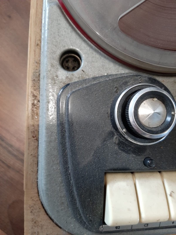

The belts of magnetophone and the record player melt long time ago ...

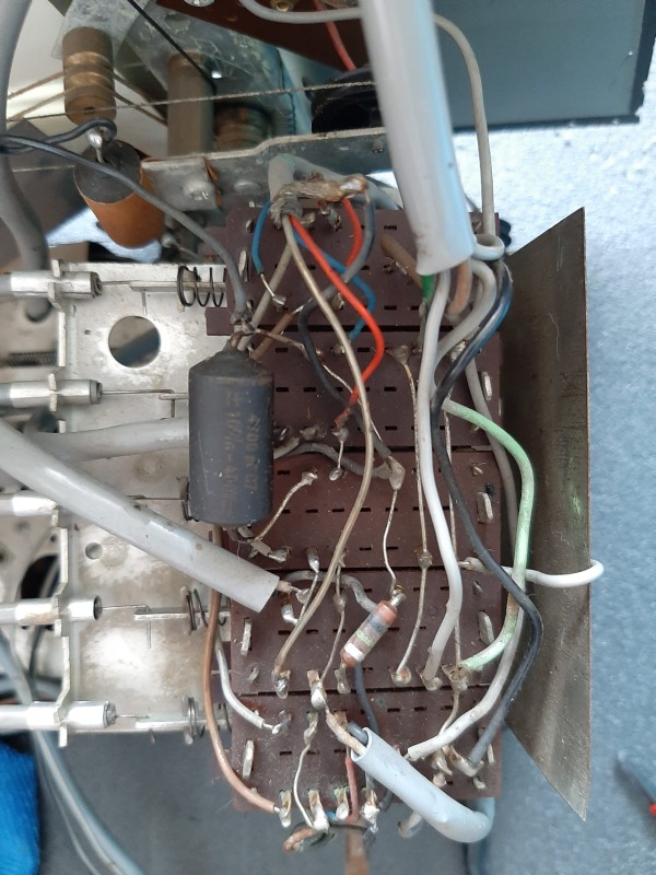

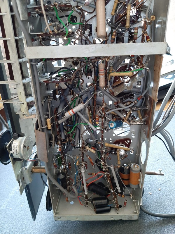

My first step was to bring it at home,
Second step to remove the dust
Third (what I am doing now), to check all the condensators, take the values (capacities + voltage) in order to order new ones.
Beantwoord door JJVox in topic Projet : Restauration F8X82A

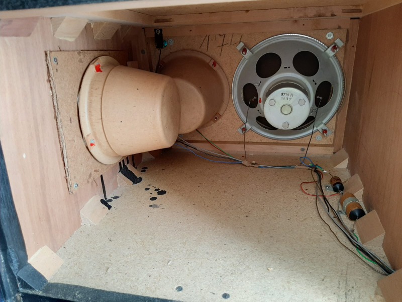

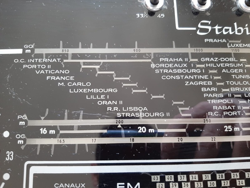

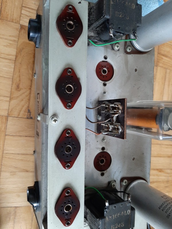

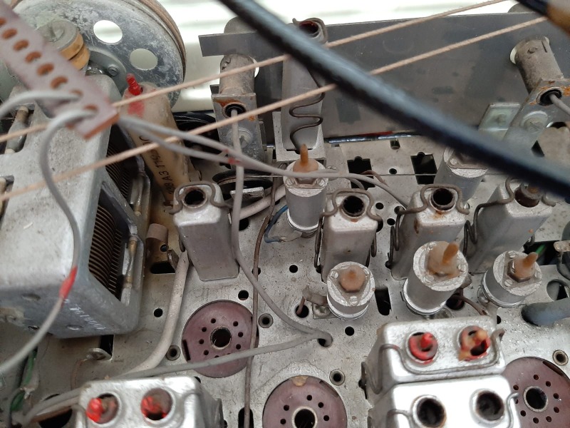

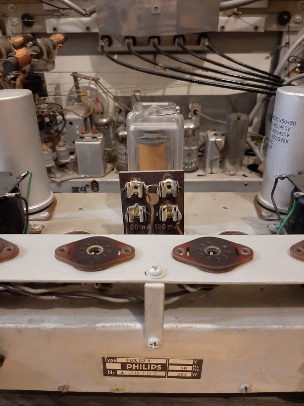

I spent a good part of my day to remove the dust.
The "dial" (?) : face with all the script, is unfortunatly not in perfect condition.
I checked the speakers, they are all alive ! \O/
Left side :
- AD 3700 BM 334 Ohms / 400 Ohms
- AD 3700 BX 300 Ohms / 400 Ohms
- 9710 A : 673 Ohms / 800 Ohms
Right side :
- AD 3700 BM 308 Ohms / 400 Ohms
- AD 3700 BX 314 Ohms / 400 Ohms
- 9710 A : 664 Ohms / 800 Ohms
I don't have the satellites AD 5036 A, but I would love them

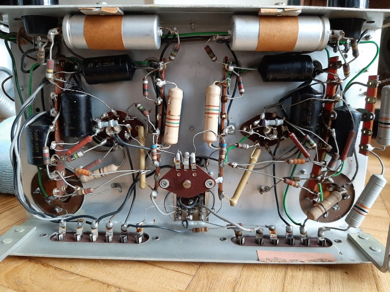

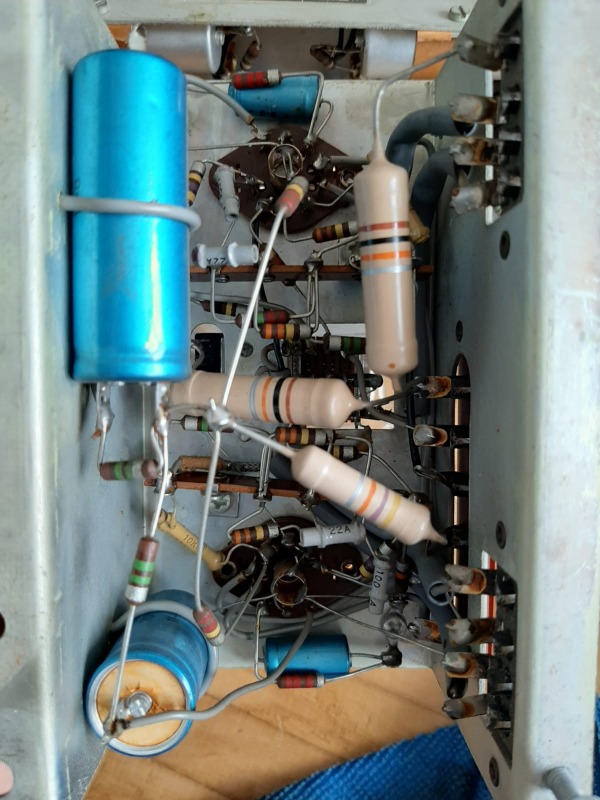

All tubes are presents and no one look bad ...
The electronic part doesn't look bad too. One fuse was dead (the question is "why ?")
Left side :
Right side :
