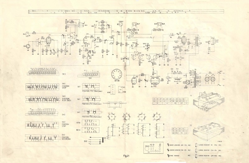

The AG8008a is very similar to the EL3542.
You can download the service manual form this link, it was more than the size limit to post it directly here.
drive.google.com/file/d/0By6GyjLhonZNSlNybGQzeVBXdTA/view

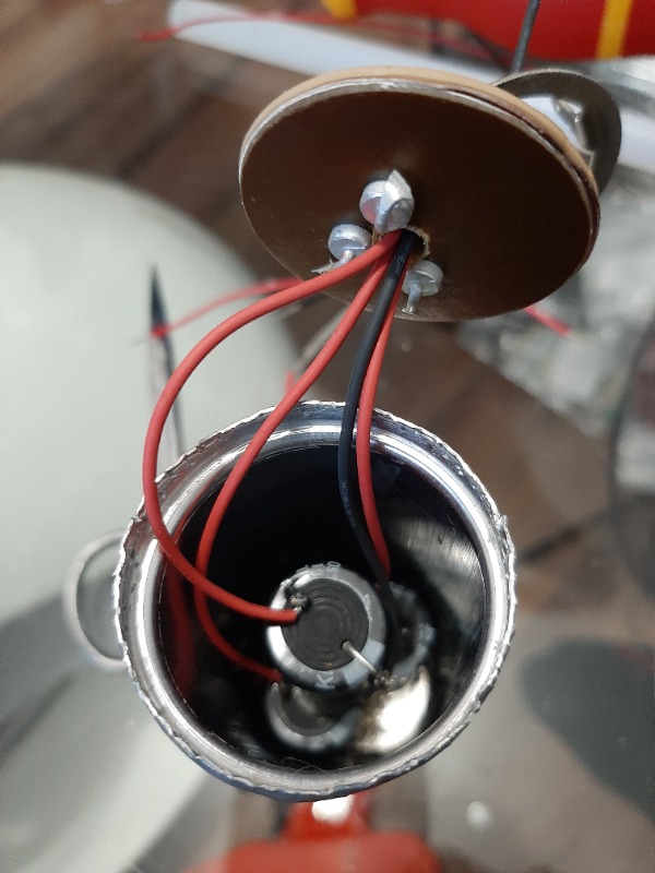

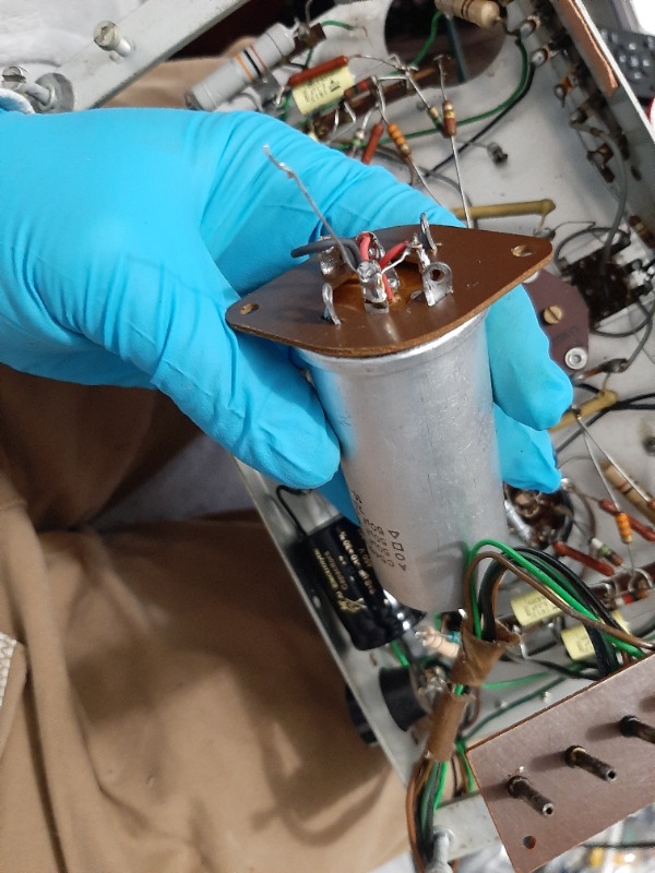

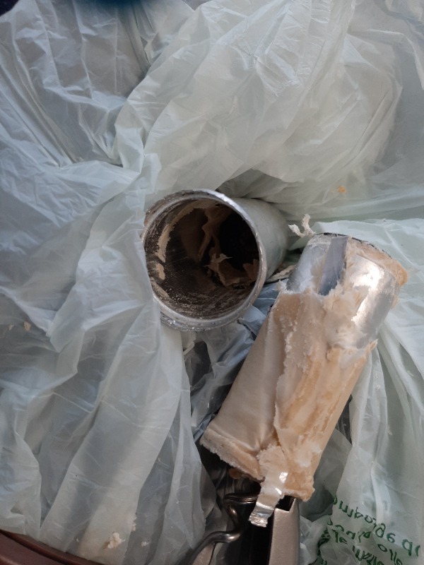

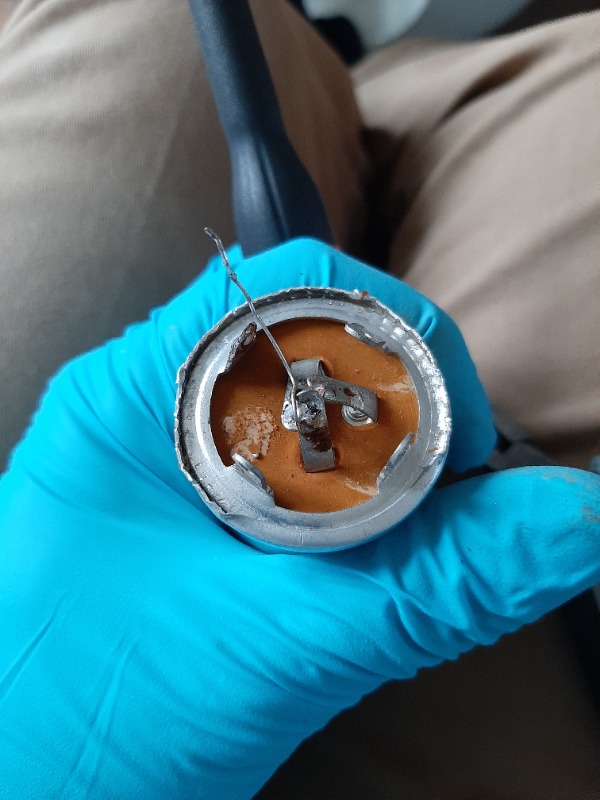

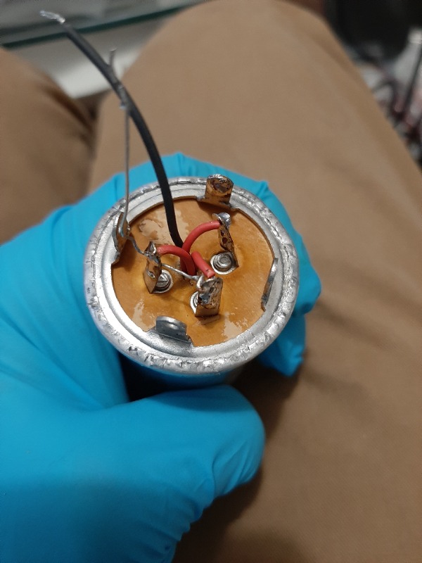

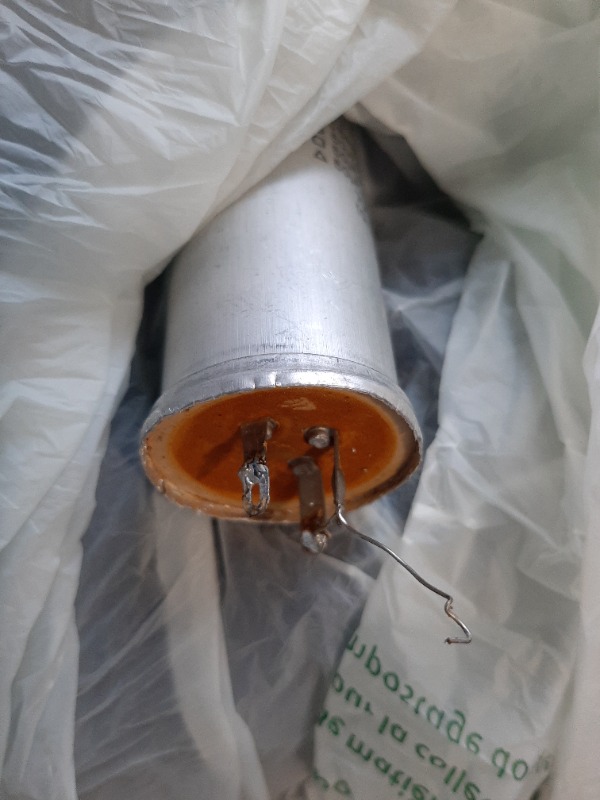

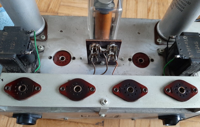

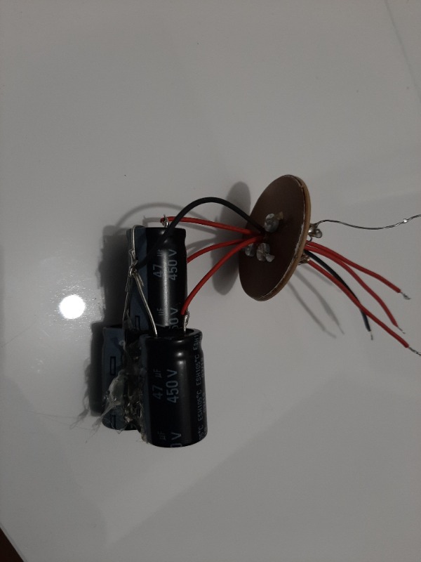

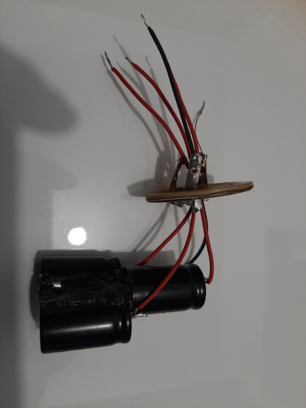

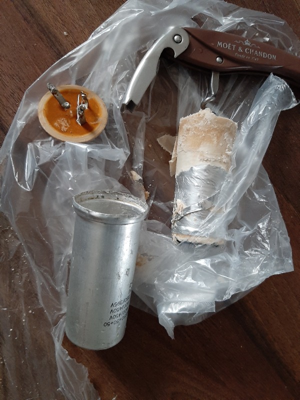

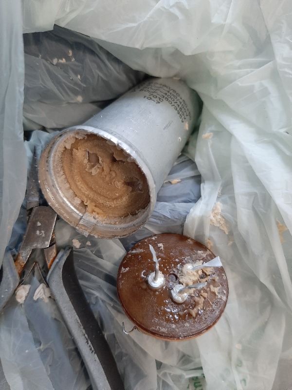

Ofc, the 50µF are changed by 47µF/450V and I put melting plasic glue to hold them inside the aluminium cylinder.
Still need to change some resistor in this part but I progress.
By the way, would you have schema of the AG 8008A ?
It would be really usefull to continue ...
