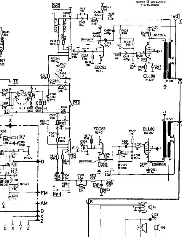

änderungen vorbehalten !
Bleek achteraf Freudenstadt14 te zijn Stom

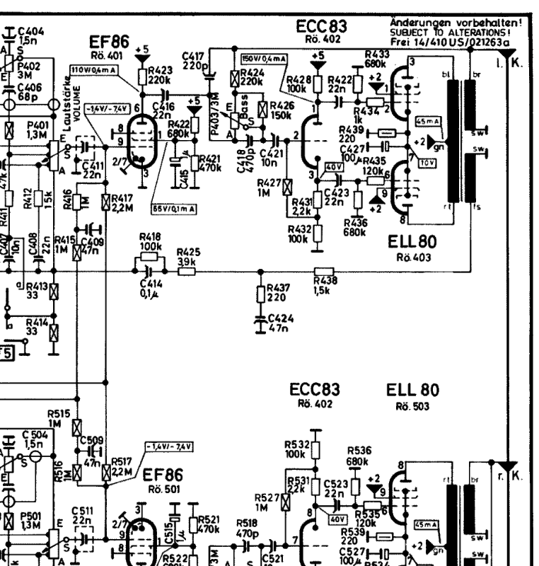

@Tjerk,
Fstad 14 heeft maar 1 keer ELL80 se voor beide kanalen.
@ TS,
Try to get a new ELL80 tube , if this not solve the problem right now , after a few years you will need this rare tube
The ECC83 is rather cheap to replace . capacitor C415/C515 are live savers for your radio, pleace replace them !
Questuon : Do you also hear one channel on tape or phono input?

Tube contacts rarely cause issues. Sockets do. But in this case try swapping Rö 403 and Rö 503 (ELL80) to see if the distortion moves to the other channel. This is the first, easy step.
